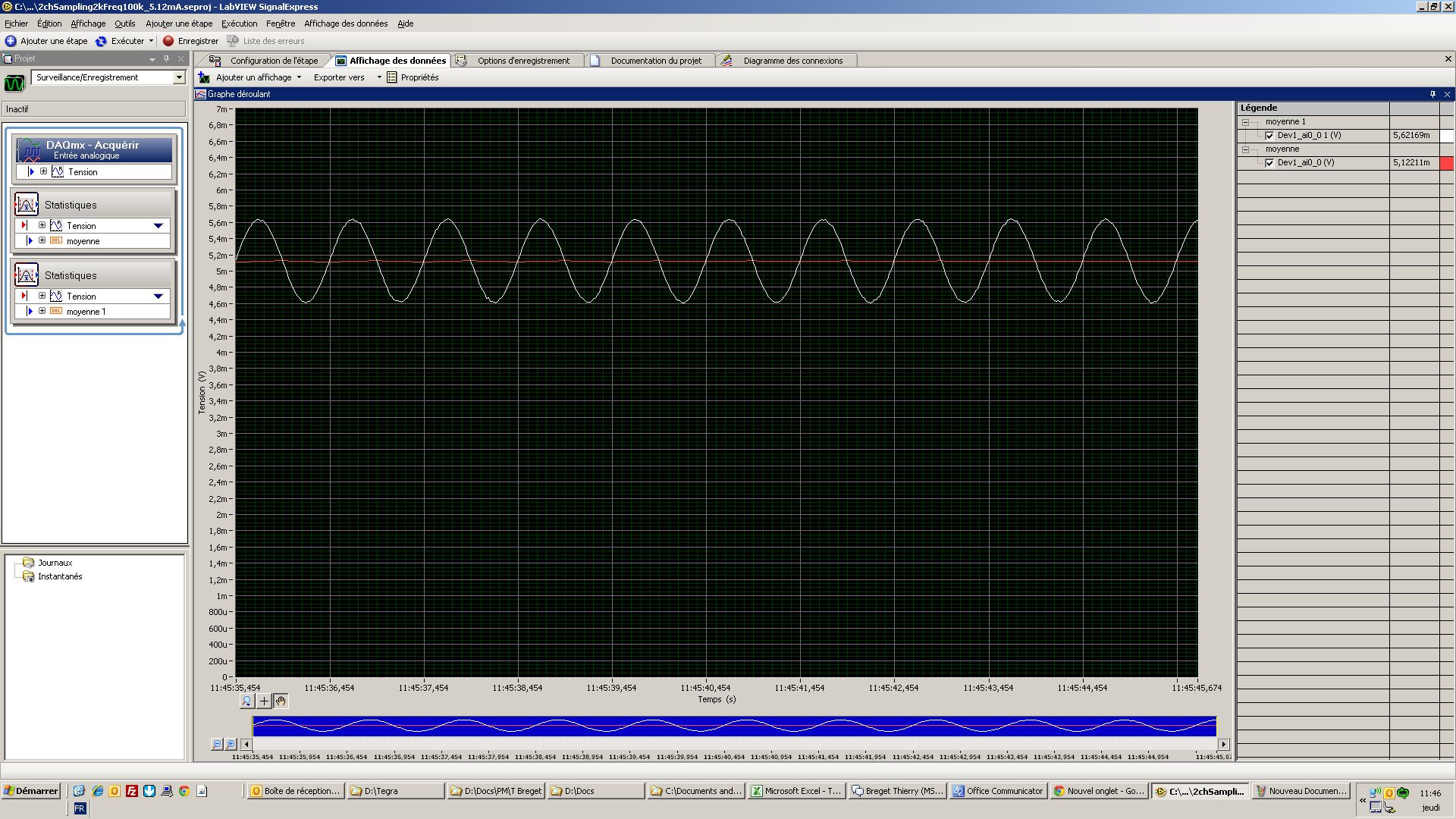

Hi Antonin,
I made some screenshot showing problem I explained:
I use a waveform generator to output sinusoidal signal at 1hz with ~5mV offset.
1/
When I configure SignalExpress with sample to read=20k, Rate=1M, 1 channel
average is 5,12mA
2/
When I configure SignalExpress with sample to read=20k, Rate=1M, 2 channels
average is 5,62mA
=>So 0.5mA higher when I add a second channel
=> Not Good
3/
When I configure SignalExpress with sample to read=2k, Rate=100k, 2 channels
average is 5,12mA
=>By decreasing rate from 1M to 100k with 2 channels, I have same result that case 1/
So it seems that with more than one channel, we can't use max sample rate possible ?
I will send snapshot by mail
Laurent

Antonin,
With snapshot
I saved also seproj config files but I can't attach them in this thread, I can send to your mail if needed
1/
average is 5,12855mA
2/
When I configure SignalExpress with sample to read=20k, Rate=1M, 2 channels (second channel not displayed,but configured)
average is 5,62893mA
=> Not Good
3/
When I configure SignalExpress with sample to read=2k, Rate=100k, 2 channels (second channel not displayed,but configured)
average is 5,12211mA
