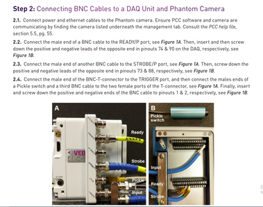

I am the first time user of the ADC of USB-6361 BNC pinout,  what I want to do is setting the trigger between USB-6361 BNC and Phantom camera.
I have searched for how to connect both, but the file which title is "interfacing a DAQ unit with a Phantom camera" is use USB-6361 screw terminal pinout for sample.
I am confused the pinouts 88 & 90 of 6361 screw terminal.
Does anyone know about 6361 BNC pinout?
