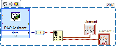

Hi all,
I am measuring two analog frequencies with the USB-6001 and Labview. I would like to perform mathematical functions on each input separately, but the DAQassist module in Labview only has one output. What is the data type of that output so I can figure out how to separate the two signals? Is there an easier way to do this?

Depending on the vi you use for reading you get a 'dynamic' datatype or an array of wfrm or dbl (you can choose by type selection).
index array will give you the seperated signals 🙂
here the express version that needs a 'conversion' into array of wfrms , but I recmoonet to look at the examples and learn how to avoid the express vis and the dynamic datatype
