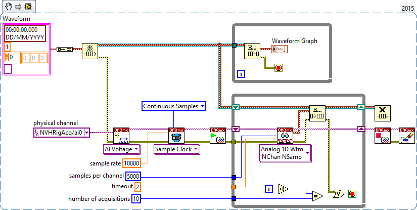

I built the VI as suggested, but it still does not record samples as expected.
At 150 kHz sampling rate, it only recorded 750 k samples in 10 s. I checked the samples along the timestamp, it recorded 15 k samples every 0.2 s.
The saved text file looks like this:
06:03:10 AM   (15000 samples)
06:03:11 AM   (15000 samples)
06:03:12 AM   (15000 samples)
I have tried varying the timeout, samples per channel, and number of iteration; but it always gives me 75 k samples per second, which is half of the expected sampling rates.

1. Good idea to move the (relatively slow) graph update out of the data acq loop.  But I think you'll probably be better off with a chart -- they're different things.
2. Bad idea to move it into its own loop so you now have 2 consumer loops pulling data from the same queue.  Just put it in the same loop as the file writing.
     What's likely going on is that one of the loops happens to get in line first to retrieve the first chunk of data you enqueue.  As it dequeues, the other loop is now first in line and gets the next chunk of data you enqueue.  And so on, back and forth.  So the file writing loop only retrieves 1/2 the total data and the graphing loop retrieves the other half.

Yes, as Kevin says in point 2: only dequeue the data in one place (one consumer loop) then do whatever you need to do with that data.  The data written to file can be extracted from the waveform that is being displayed on the graph or chart.
Andy
