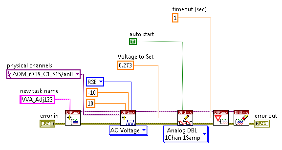

Eureka! This is the bit I was missing: that I can dynamically edit a task at runtime in LabView. I had been manually creating test tasks via MAX/test panel and then hadn't been able to figure out how to alter them in LV (I missed the VIs and then was trying to use property nodes and couldn't find a way to get there.) But with your help I knew what I was looking for had to be there and eventually found it.
Is this the right sequence of commands? This does seem to work, and obviously I'll wrap it up in some more abstraction for real use, but I just want to make sure I'm not missing something that will be a gotcha later.
Thanks again, I really appreciate the kick(s) in the right direction.

You've pretty much got it.  Let me show you an alternative below the way I'd do it and comment on the differences.  You might also want to look at the shipping examples (Help->Find Examples...).
1. I rarely call "DAQmx Create Task" at the beginning because I don't generally need to name my tasks.  It's optional and doesn't hurt if you want to leave it.
2. I demonstrated how to create 1 AO task that includes 4 AO channels (note the colon-based range syntax ao0:3).  You can easily select multiple channels if you click the drop-down arrow, then pick Browse...
3. I call DAQmx Start explicitly rather than use auto-start.  Sometimes it doesn't matter and auto-start can be a useful shortcut.  My habit is to stick with explicit control because there are times it allows more efficient operations.  The reason why relates to the DAQmx Task State Model, which is too much to get into right here.
4. Because I'm demonstrating a multi-channel task, when I write new voltage values I need to write them as an array with one element per channel.  They'll all update at once.   It would be typical if this call to DAQmx Write were the only DAQmx call you put in your main loop.  Everything else would happen before or after the loop.
5. Because I expect to update the voltage values, I want to keep the task running throughout my app.  I don't call "Wait Until Done" because I'm not going to react to this so-called done-ness.  (And for this kind of software-timed on-demand output task, the notion of "done" probably isn't going to be useful.  Not sure I've ever explored it.)
6.  At the tail end of things, I typically call DAQmx Stop explicitly before calling DAQmx Clear.  It often isn't necessary, more of a habit that I consider good practice.  (Also, certain kinds of task manipulations have me calling Stop and Start multiple times within an app, but calling Clear only once.  I've gotten used to thinking of them distinctly and calling Stop explicitly even when I might not need to.)
