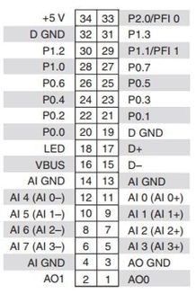

I have a USB 6001 that I connect to a USB port on my Windows laptop. Please see pin configuration below. Pin 18 on USB 6001 OEM points to the LED. But when I connect an actual LED to that pin relative to a ground [Pin 19] - the LED does not light up. What could be causing this?
The same LED does light up when I connect it to +5V [Pin 34] and Ground [Pin 32] - thus proving that the LED is fine and the DAQ is connected to the laptop. FYI - my intent is to have the LED mounted on a panel on my enclosure to serve as an indication of successful DAQ connection. Appreciate any help/guidance. Thank you.

Don't know where your pinout is comming from, the USB 6001 spec tell me another pinout....
however: The mentioned LED output could be configured as an open collector output, so you should try to connect the LED (in series with a current limiting resistor , say 470 Ohm!)  between +5V and <LED>pin .  (with Anode to to +5V 😉 )

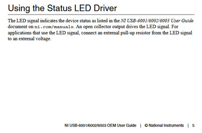

Maybe I'm reading the datasheet wrong, here's the section I'm looking at (for 6001)

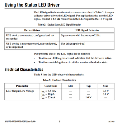

And for the 6009:
Both say "An open collector drives the LED signal" and gives a very similar electrical specs table. I'm no EE, so I fully admit I could be wrong, but that's how the sheets read to me. The only difference I could find is that the 6009 says it's pulled up when the system isn't configured, which confuses me since it also says to add a 4.7 kOhm pullup for applications that use the signal.

See below - the guide advises to connect the LED to a +5V via a pull-up resistor, but what I was doing was simply powering up the LED from that pin with reference to the ground! So, when the LED was functionining fine [i.e. DAQ was enumerated, configured and not suspended] the LED would keep blinking [@2Hz], and when it was otherwise, I would simply get a steady LED light [when suspended but DAQ connected to the PC]. And of course when disconnected from the PC, the LED would turn off too.
