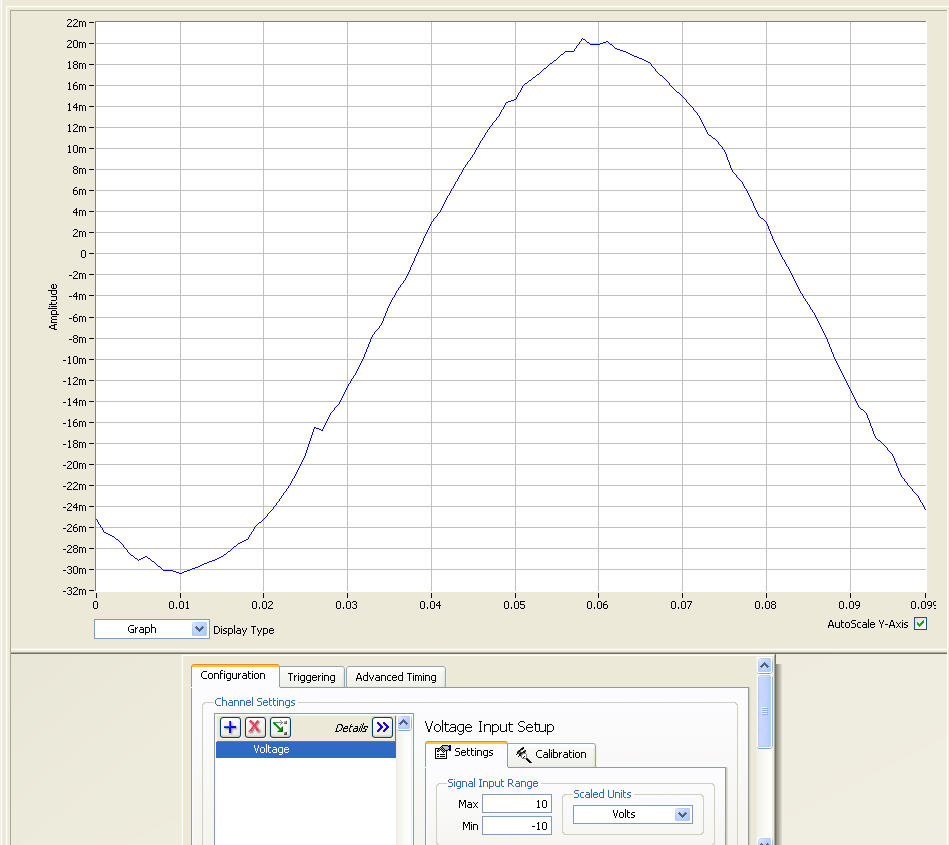

I am not sure how you are currently setting up your channels/tasks, but in this example I’m predefining the voltage task in measurement and automation explorer (max). Once saved, the task can be used in conjunction with the usual DAQmx functions  in LabView. Below is a quick example of the effect of the input channel range.
I am generating a 20mV sine wave via an analogue output channel, and then reading it in via an analogue input, under two difference analogue input ranges. In the screencap shown below, we acquiring data over the full +/-10V input range.
In the next screen cap, the input range was set to the minimum +/-200mV analogue input range. The data acquired using this range has a much better resolution. This is because the input voltage range defines the gain applied to the input signal.

just have one question. if we generate a sine waveform signal, why the maxmium singal is 20m and minimum singnal is -30ms ? I got this problem with a measurement of voltage, zero position seems not correct. How can i solve this problem. Thank you very much!.
