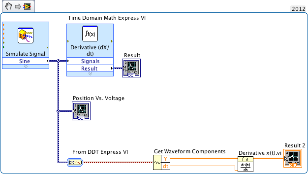

If you are using the DAQ Assistant the easiest way to take the derivative is probably the "Time Domain Math" Express VI.
If you want to use the lower-level VIs the conversion you need is to first convert the data into a waveform (or array of waveforms if you have multiple channels) using the "From DDT" Express VI and then get the waveforms Y and dt components using the "Get Waveform Components" node.
Here's a picture with the nodes labelled so you can using Search/QuickDrop to find them:
Hope this helps, good luck with the rest.
Simon
