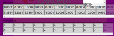

I tried running using this method and was not successful. However, when I removed this feature and write/read using the hardware trigger, it did run the correct amount of movements and reads. However, it would always miss the first 3 readings, and ran successfully for the rest of the loops.
I attached my complete VI to help with explanation. The "Move and Check" case is the setup you provided. "Move and Check 3" is the same without the manual pulse generation. "Move and Check 3" provided me with the following data on 10 movements:
Note that I'm watching the read and write voltages on a scope and they are all correct - but the DAQ is not reading the first three positions.
Sorry for the messy code - I'm working on a remote laptop.

When I change the ai to read channels "ai2:1" I do get readings for each movement, though the values are 1/2 of what I expect. I am okay with that, though.
Message 6 of 12
(3,657 Views)
It seems the max reading that the analog input can read is ~5.38V. Not sure why... the datasheet says "Input range ±0.2 V, ±1 V, ±5 V, ±10 V" which is a bit confusing.

   I misunderstood.  Back in the original post, you said "I am using a trigger signal to tell the mirror when to read and write."  That sounded to me like your were in control of *generating* this signal.
   The sync scheme I posted *depends* on carefully sequencing when AO and AI tasks start relative to when the pulse signal starts.  If the pulse signal is external and free running, i.e., If you can't be sure that AO and AI tasks are started *before* any pulses are present at PFI0, then you can't be sure the tasks will be in sync.
I'm not able to look at your code now so I can't really interpret what's wrong about the data in the front panel screencap.  I can only guess it's related to the sync issue I mentioned in the last paragraph.
Here's a method to re-guarantee sync without the CO task.
  • Configure AO to be triggered by the rising edge of the external pulse while using the falling edge as a sample clock.
  • AI should be triggered by the terminal signal "/Dev1/ao/SampleClock" while using the rising edge of the external pulse as a sample clock.
  • The AI task needs to be started *before* the AO task.
This combo will satisfy the timing diagram you showed in msg #1.  AI is started first, but external pulses won't cause any samples to be taken until AI gets triggered by AO.  Later, AO starts and gets triggered by the next pulse rising edge.  AI still doesn't take a sample because it still hasn't been triggered.  The pulse's next falling edge will cause AO to generate its 1st sample, and this sample clock signal will in turn trigger AI.  Then the 1st AI sample will be taken on the *next* pulse rising edge.
