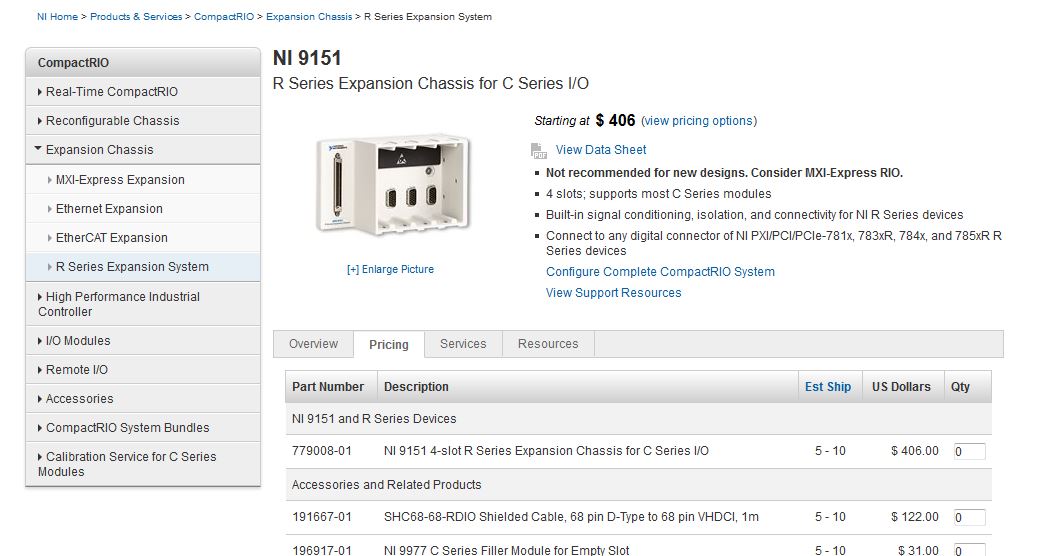

i'm sorry but SEA 9521 hardware manual says that "SEA 9521 BiSS Interface Module with 3 * BiSS interfaces to connect absolute digital position encoder to the CompactRIO system from National Instruments"
Cattura.JPGhowever, is there any NI device i can use with a compactRIO system to read from a absolute encoder?
(4,686 Views)
also i made a typing mistake in the main message: it's compactRIO NI 9151 not NI 9251
(4,677 Views)
