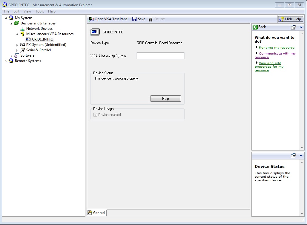

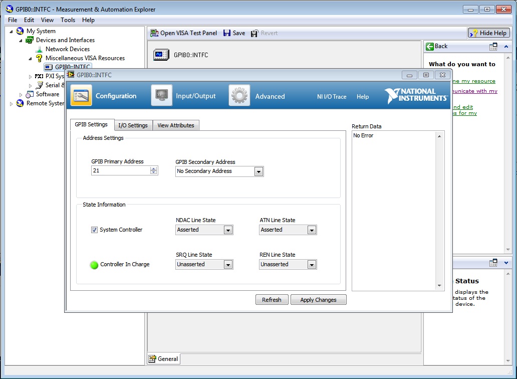

I managed to make it seen with Automation explorer, not sure if it is seen correctly, here are some screenshots
In this last picture you can see the NI example i am using, the gpib board number and device address are correct since they are the same I use with CVI.
Thank you
Message 9 of 14
(6,142 Views)
In order to make your device visible for the Measurement Studio environment first you need to make it work with MAX.
Which version of NI-VISA and NI-488.2 drivers do you have on your computer?
Miguel Fonseca
Applications Engineer
Message 10 of 14
