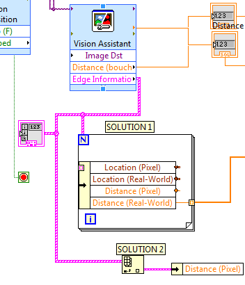

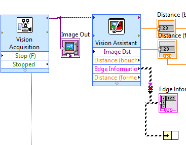

I want to use only one parameter of the indicator edge information in the block vision assistant, so I used unbundle by name, but it tells me wire broken, how can i solve that,

so i find solution in this post: https://forums.ni.com/t5/Machine-Vision/How-do-I-get-the-Position-Cluster-Information-from-Calibrate...
just i don't understand why a for loop can solve that!

The output which you are receiving is array of cluster data.
-So when you use for loop by default for loop uses auto indexing hence you get one element(Cluster) which you can unbundle.

when one array is inside a cluster or vise versa
cluster inside a array it make some times confusing sense
but always regard that if cluster is inside array you have to first break array apart with some method like
using for loop or delete from array and then use unbundle to take a part data
but in second type first you have to use unbandle then use for loop or delete from array for this job
in above question first method you have to use it
