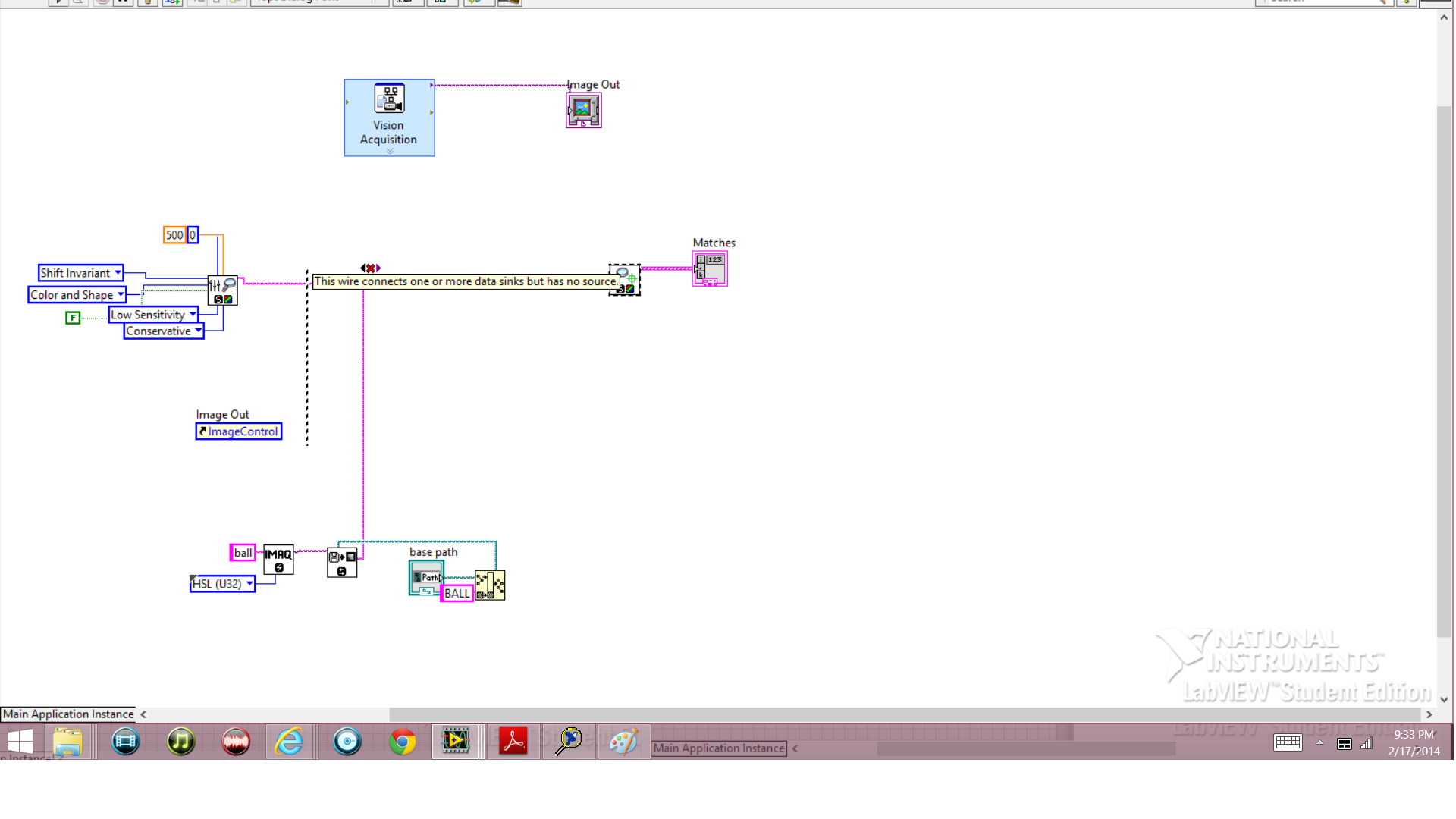

Ok so I'm experimenting with your Draw Pattern Matches block.  And I keep getting error code.
I looked it up and it says it's a formatting error with the picture I'm trying to save, so I switched it as a PNG and still to no avail.
I've included the VI and the image I'm trying to initially go through.  As well as pictures of the current running code and error:

the draw pattern match.vi just overlays the matches found - it does not perform matching. You should use the color_matching.vi (if you check the code carefuly, you will see that the draw pattern match.vi is a function (subvi) inside). So in order to save the images, do it in the main program (color_matching.vi). Also, be careful with objects touching the border, since you need to have a sufficient padding to process this. I would avoid objects at the image borders.
Regarding your problem saving .png - check the "IMAQ Write PNG File" function (it does not accept hsl). If you want hsl, I think you will need to use "IMAQ Write Image And Vision Info File". You can only write the file as a .png.

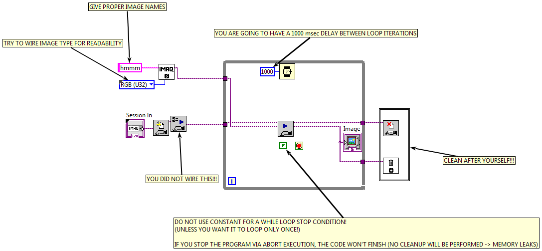

Ok so I decided to start small, with just basic camera acquistion.
I decided to use the grab function, in a while loop but it seems not to be working, i thought this would allow my camera to repeatedly take pictures, as i was able to take one picture without the while loop, but upon putting it in a while loop my camera just stays on and I don't acquire any pictures.   Any ideas?

patience and slow initial pace is the best way to go at learning new stuff. Always double check your actions...
Why does it not work along with some suggestions:
