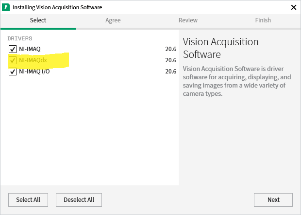

Hello, I downloaded Labview for university about two days ago and I actived the addition package (see the first image) that professor saied me.
When I open Labview and go to Visual and Motion i don't see the icons that i need for my university course.
How can I solve?
Thank you

I have download all these add-ons and activeted them. The problem is: in visual and motion's  menu there aren't Imaq-dx's icon.
I don't know how to fix

When install VAS, make sure you select the IMAQdx option.
If it's already installed, you should be able to find it under vi.lib folder.
You can manually add it to the Vision Motion palette.

Hi, I don't find the vi.lib folder. I reinstalled VAS selecting the options in the image, but the IMAQ's icons there aren't in the palette.
Do you think something wrong?
Thank you for the help you giving me.

Is this the mistake?
For 32 bit LabVIEW:
C:\Program Files (x86)\National Instruments\LabVIEW 2017\vi.lib
For 64 bit LabVIEW:
C:\Program Files\National Instruments\LabVIEW 2017\vi.lib
Are you using 32 bit or 64 bit LabVIEW?
The bit of Vision must match LabVIEW, or you won't see it on the palette.
George Zou

I find the folder and the add-ons are installed.
I use x64 version of Labview, I controlled all the descriptions of the add-ons, they can be used for x64 and x32.
At the moment I'm reinstalling Labview.
The professor said  to download 2017 version, and the version can be used with max windows 10, I don't know if this version can be used for windows 11 of my computer.
What do you think ?

LabVIEW 2017 is not fully compatible with Windows 11.
LabVIEW 2022Q3 is.
LabVIEW and Microsoft Windows Compatibility
