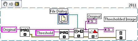

If you're like me you're a visual learner, so here's a picture.  (There's also a shipping example in LabVIEW called Threshold Example.vi, but it's not for beginners.)

Almost perfect: Do not call "IMAQ Dispose" as long as you need an image (even in an IMAGE Display indicator).
As you have not wired an image to "IMAQ Dispose", no image gets disposed.
(3,454 Views)
GuenterMueller,
Good catch!  I want to amend your statement just a bit though.  We should always call IMAQ Dispose any time we call IMAQ Create (once we're done processing of course.)  Otherwise the image reference remains in memory until we quit LabVIEW.  If we want the image to remain in the indicator after the program finishes we have to right click on the indicator and choose Snapshot.  This keeps the current image in the indicator until a new image is sent to it.  You're absolutely correct though that in my example the image reference never actually gets disposed.  We would either have to wire the image reference to the dispose VI, or wire a true constant to the dispose all input.  Thanks for catching this.
