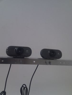

Hello Ronak,
i have tried to set up a stereo system using the two cameras i mentioned in the previous post. My settings were:
Cameras focus = fixed focus 400 mm (camera technical specifications), no tilt angle
a. Baseline distance = 200 mm.
b. Baseline distance = 100 mm.
Image (setup b.):
Using this setup i get the following 3D reconstruction (see attached file):
Now i have a couple of questions:
1. The surface should be straight. Why is there so much deviation? Is this because of lack of texture?
2. There is white padding around the object - is this also the result of the lack of texture, combined with the matching window size? The background is white and uniform, so getting texture there is impossible without a projector.
I am attaching everything needed to reconstruct the calibration and measurements for setup b. if need be.
You have mentioned that i should flip the images - so looking at the cameras from the front, the right camera produces left image, and the left camera the right image? I followed your advice and this is obviously right, but that is contradictory to the stereo vision concepts manual (Manual 2012), where the setup is diffrent?
You also said that to determine the relative position of both cameras, around 6-7 grid images are enough. Is this after individual camera calibration (after already correcting distortions etc) right? I think to effectively correct the lens distortion, more grid images should be acquired.
Thank you for all your help and best regards,
K
P.s. Attaching the files in 3 steps because of the upload limit.

Accepted by Klemen
Hi Klemen,
   Great work. Finally you are able to get 3D. Kindly find my answers below:
Q: The surface should be straight. Why is there so much deviation? Is this because of lack of texture?
A: According to your stereo setup, 100 mm baseline, without tilt angles, 1 inch between two dots and 25 inch object distance, you should get a depth resolution of 0.02 inch. For this computation, I have assumed some more parameters: 8mm focal-length and 4.8x3.6 mm sensor-size. That is, depth values, if correct, can be in 0.02 inch range of the correct depth values. I see that variation in the depth image. In order to improve your resolution you can bring the object closer or increase the focal-length. Alternately, you can increase the baseline and tilt your cameras. However, given a stereo system, you will always have a region of uncertainity. This issue is not because of lack of texture.
Q: There is white padding around the object - is this also the result of the lack of texture, combined with the matching window size? The background is white and uniform, so getting texture there is impossible without a projector.
A: Yes this is definitely due to lack of texture. Can't do much about it except using a patterned (random) light projection.
Q: You have mentioned that i should flip the images - so looking at the cameras from the front, the right camera produces left image, and the left camera the right image? I followed your advice and this is obviously right, but that is contradictory to the stereo vision concepts manual (Manual 2012), where the setup is diffrent?
A: Ohh..That was just for explaining the stereo concept. So, we never really thought from that perspective. However, I shall inform to the documentation team about this. Thank you very much for intimating. I really appreciate this.
Q: You also said that to determine the relative position of both cameras, around 6-7 grid images are enough. Is this after individual camera calibration (after already correcting distortions etc) right? I think to effectively correct the lens distortion, more grid images should be acquired.
A: 6-7 grid images should be sufficient for all the tasks, if you capture them properly. So, if you look at the stereo example, you only need to cover one V-region on either left or right side of the grid. In practice, 5 images should be sufficient. We advise for more so that user need not to worry about angles and coverage.
I hope this will help.
Ronak.
