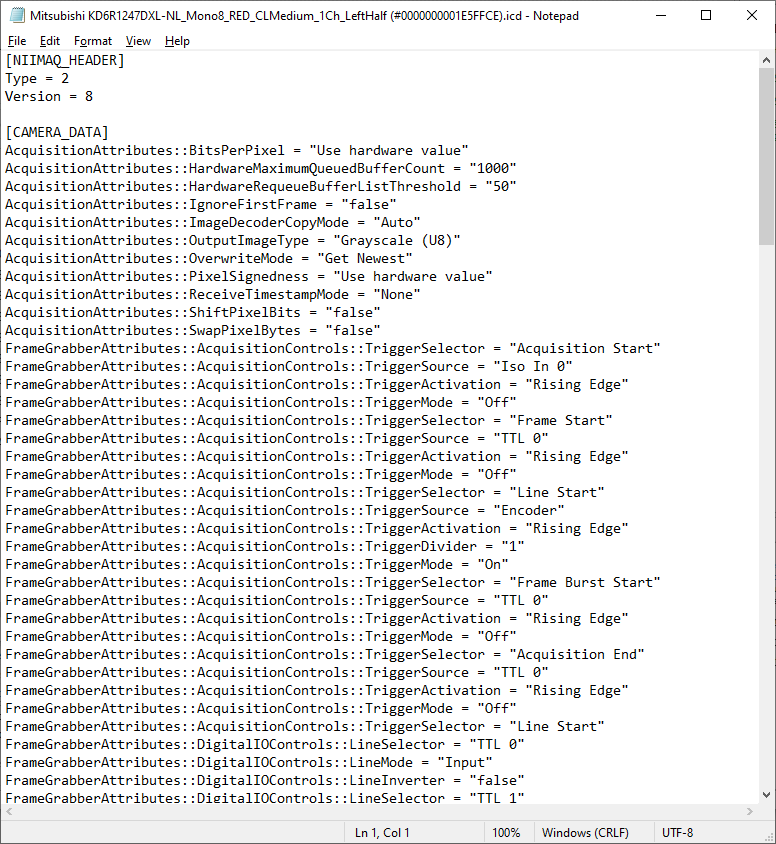

IMAQdx .icd file is missing the following attribute
Frame Grabber Attributes :: Encoder Controls :: Encoder Use IO Board Input
When NI MAX opens the .icd file, the following combination is ignored:
FrameGrabberAttributes::AcquisitionControls::TriggerSelector = "Line Start"
FrameGrabberAttributes::AcquisitionControls::TriggerSource = "Encoder"
FrameGrabberAttributes::AcquisitionControls::TriggerActivation = "Rising Edge"
FrameGrabberAttributes::AcquisitionControls::TriggerDivider = "1"
FrameGrabberAttributes::AcquisitionControls::TriggerMode = "On"
The Trigger mode will be "OFF" in NI MAX

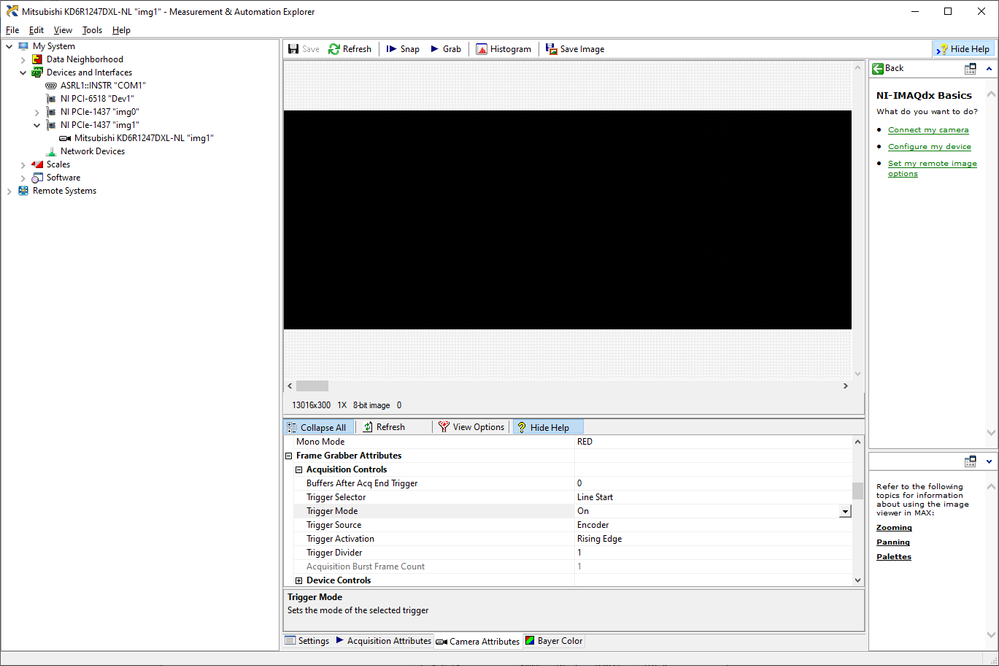

NI MAX Saves the camera setting Trigger Mode "ON":
The .icd file says "ON"
Reopen NI MAX, the Trigger Mode is "OFF":
Trigger Mode OFFTrigger Mode OFF
Encoder Use IO Board Input is disabled.
Use IO Board not enabledUse IO Board not enabled
