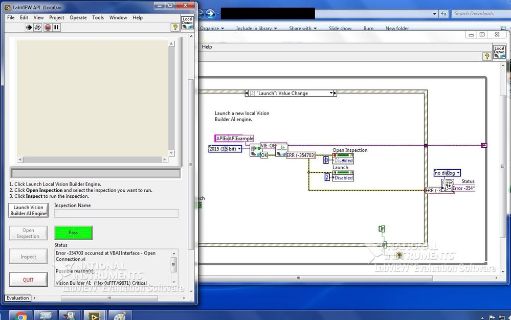

Im trying to run VBAI2015 in LV2015 (Evaluation). I load example <NI>VBAI 2011/API examples/LabVIEW. Error 354703 appears when I "Launch Vision Builder AI Engine". I try to create simple prog similar to the example, same error. I attached files for review.

Its been a month. I tried to uninstall all National Instruments products from my PC and re-installing LabView 2015 32-bit, VBAI 2015, yet the error still there. Either using example <NI>VBAI 2015/API examples/LabVIEW or  Simple API test.vi both return Error 354703.

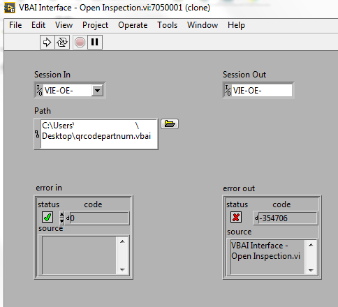

Accepted by tr_dane
It looks like in the latest screen shot you're getting a different error that is about the inspection not being valid. For the inspection to open without errors, make sure any resources it uses are available (i.e. if using a camera, make sure no other application is using the camera, and any VI used by Run LV step is available at the expected location, etc.). Try closing VBAI and MAX and anything else that may be using resources. If the problem still persists, try rebooting and opening the VBAI inspection from VBAI and see if there are any issues opening the inspection in the VBAI environment. If so, fix them and save the inspection. If not, and you still get errors after closing VBAI and running your code, please attach your inspection so we can see what it is doing that might cause it to be broken when opened from LV.

Thank you Brad! After re-installing everything... again, example in <NI>VBAI 2015/API examples/LabVIEW can run without a hitch. I found out there was a Fail step in the vbai inspection.
That is why vbai file could not open from LabVIEW API Example (Local).

I've got the same issue, but before to open an inspection.
I've only try to open VBAI with the API (not opening an inspection). The API UI is openning, but before it finnished is "Open Connection", It occurs an error:
"Error -354703 occurred at an unidentified location
Possible reason(s):
Vision Builder AI:  (Hex 0xFFFA9671) Critical components of Vision Builder AI are missing or not installed."
