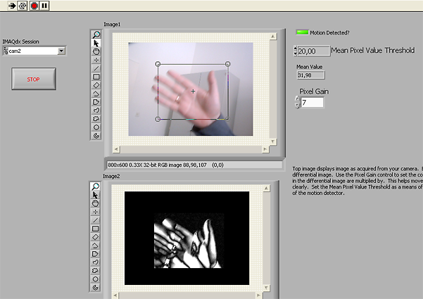

It's possible apply a ROI function on the motion detection alg (http://decibel.ni.com/content/docs/DOC-4717) to detecting movement ONLY in a specified area?? Thank You very mutch!

Sure. Just use IMAQ ROItoMask and then IMAQ Mask before (or after) calculation of Absolute Difference.

redmercury wrote:
Can you attach an VI example of this??
Something like that:
result (take a note that my camera deliver RGB image, so the original example is slightly modified):
VI in attachment.
Andrey.
(5,147 Views)
