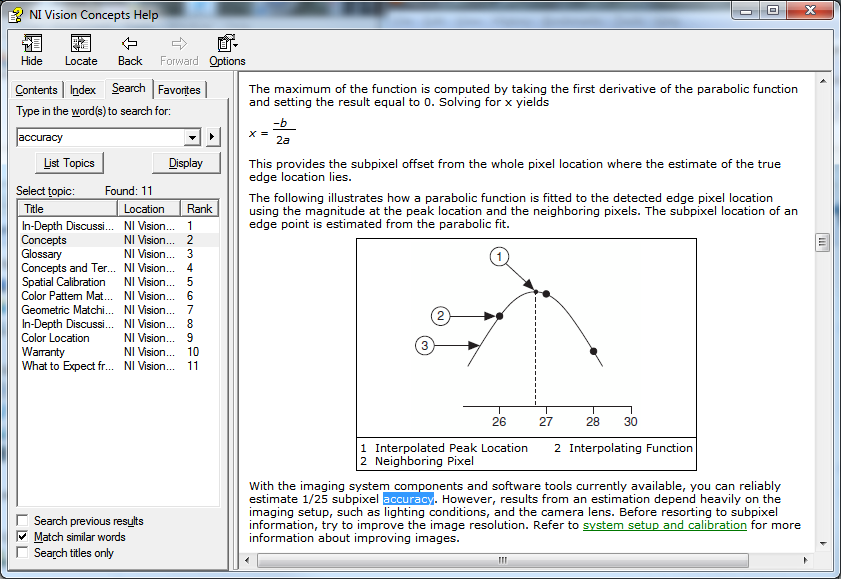

Hello simple_me,
The subpixel accuracy is actually about 1/25 of a pixel. You can find a detailed information in the NI Vision Concepts Help by navigating to Start > Programs > National Instruments > Vision > Documentation > NI Vision > NIVisionConcepts
21523i3C8326F09F34A63D

Thank you Andy, I wasn't aware of the documentation files.
