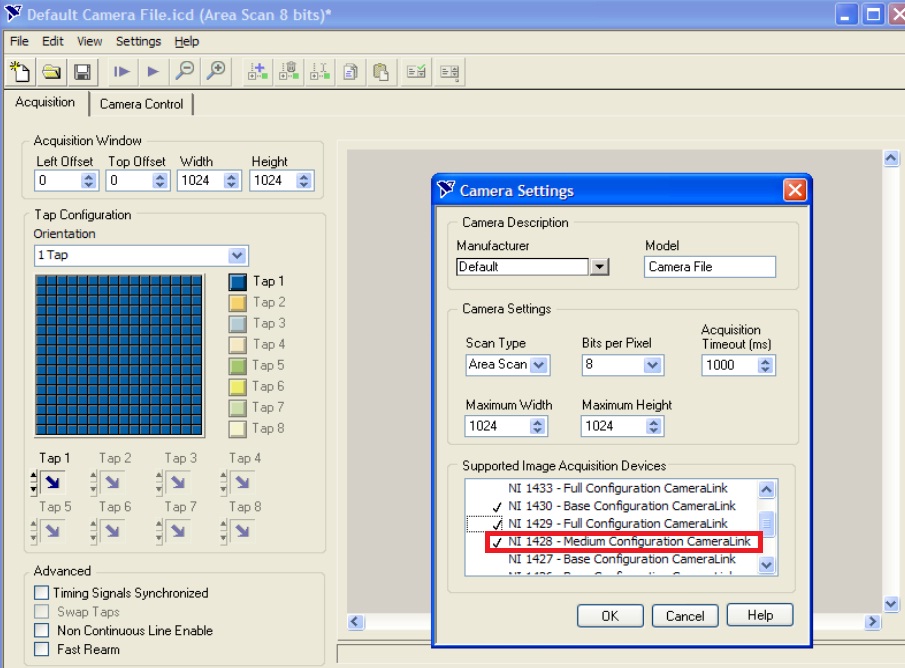

I am using the NI PXI/PCI-1428 board. I am sending a camera link video (coming from an FPGA) to the frame grabber. I have been trying to create a custom camera with the camera file generator program, but it only gives me the medium configuration option. Therefore, when trying to acquire video, it gives me the 0xBFF60022 timeout error. It is because it is expecting video in medium configuration and i am sending it in base configuration.
The Ni 1428 board clearly supports base configuration.
Camera file generator
Any clue?

I suspect it has to do with your image size.  Try a smaller image.
You can also edit the file manually once created, using notepad.
