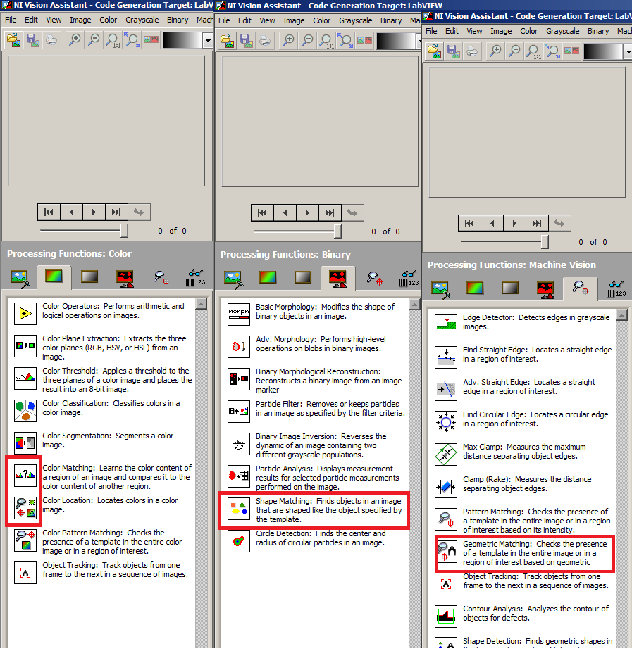

colleagues,
I managed to make a VI that takes my picture, now I'm interested in whether anyone can check if everything is fine? And now it remains to make the Vision Assistant adjust the parameters that we like to detect the color and shape of the object. VI is attached for verification
(4,918 Views)
what you did is not correct indeed bellow image show what you want in VS  to use so work with them
also check the links that I send you in previous post it will help you
and do not forget for color analyse you never should spread color channels
also intensity matching is irrelevant for your work
