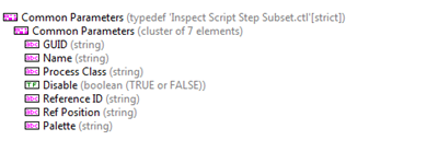

Hi!
I need a little assistance about IVB Generated vis. According to set step status[Common Parameters - Disable] in VBAI: - Disabled/ Enabled,
in the generated code, the step status always enabled.
How can I set the status - Disabled in the generated code? takig care about all conclusion i.e.: Measurement points won't be available/ or Coordinate System... and so on

The disable flag is ignored in the generated code. I have create CAR#238729 to track this problem. We will try to address this in a future release. In the short term, you can go to the Code for any steps that may be disabled and modify them to look like the attached image. Let me know if you have any questions or comments.
I just put a case structure around the Code and ignored it if the disable flag was true.
Sorry for the inconvience.
Brad
