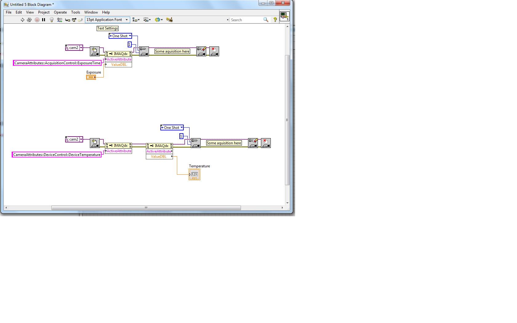

Hello all,
I would like to read some properties of the camera I am using.
I am using IMAQdx Enumerate Attributes to obtain the list of what the camera can return, and the list contains
CameraAttributes::DeviceControl::DeviceTemperature
CameraAttributes::ImageFormatControl::SensorWidth
CameraAttributes::ImageFormatControl::SensorHeight
These three properties are said to be Readable, returned as I64 for the sensor and Double for the temperature.
How do you access these values?
As crazy as it sounds, I have found how to write an attribute (using property node on the IMAQdx session with ActiveAttribute and Value, both as write), but not how to simply read it.
I have tried to link a property node ActiveAttribute in write, then another property node value in read. No success so far.
Configuration : Labview and Vision 2016, IMAQdx 2016-09 and a Basler acA1920-155um

Here is an example of what I am trying to do.
The top code would work. It is actually a stripped down version of what I do, and it works.
The bottom one is what I am trying to achieve but I get an error, property not supported by device, while I am certain the camera can (it is listed as readable and Basler indicates it on their website).

You will get an error if you have a blank ActiveAttribute in your property node before you read out the value.
You need to write the ActiveAttribute in the same property node as you read the value from.  You can right-click the property node variable and select "Change to Read" or "Change to Write".
