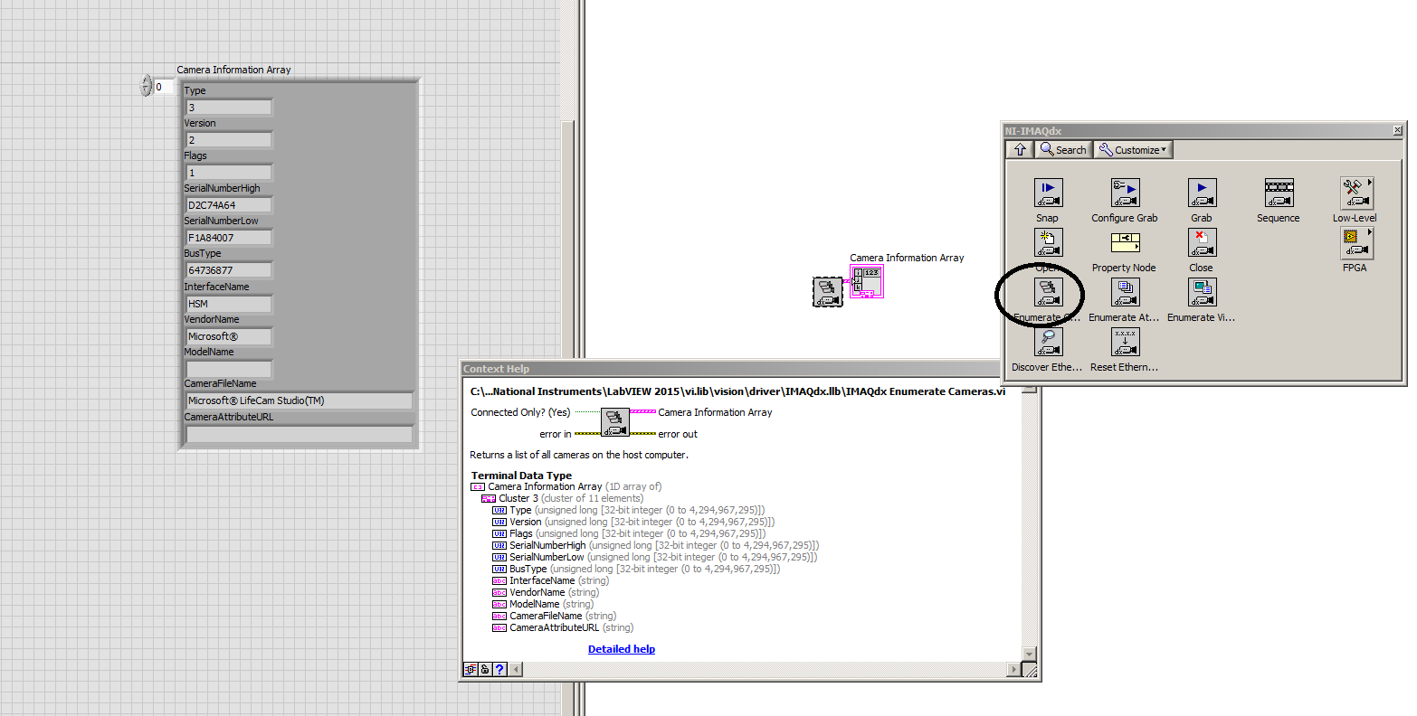

USE THIS VI  YOU CAN FIND YOUR CAMERA NAME AND INFORMATION YOU CAN USE THIS INFORMATION TO FIND YOUR CAMERA AFTER THAT YO CAN MAKE STRING BASAED ON YOUR CAMERA INDEX IN THIS VI OUTPUT ARRAY
FOR EXAMPLE IF YOUR CAMERA IS FIRST ONE SO INDEX IS 0  AND YOU CAN ADD CAM0 STRING TO YOUR IMAQDX SESSION

I was wondering, there is no input for IMAQDX SESSION so how can I change it programmatically?

Just a GigE vision camera.
I think I got what u meant after reading this http://digital.ni.com/public.nsf/allkb/4A096593E2BD63BE86257D49007A5B30. Thanks for your help!

this link is exactly what want to say
