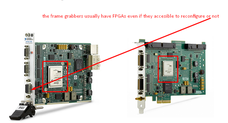

IMAQdx actually does a lot of processing since most of the frame grabbers has FPGAs on them, even if there are not reconfigurable. That sound like a really nice approach I hope that you do it work. This is what the community is for! Discussing awesome new applications and get costumers and NI personal in touch. I am completely sure that you can come to the community or even calling the support line if you have questions about LabVIEW programming.

For example this FPGA is used to do processing and to reduce noise. The Frame grabber also has internal buffers in order to able to store information that can be accessed and manipulated.
Something really important is that you have to load the camera file in order to get the correct configuration of the camera attributes before setting up the acquisition. For example the tab configuration. It depends on the camera too but some of them need triggering, exposure time configuration and bit-depth configuration.
