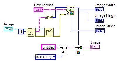

I've had a similar task of converting JPEG image stream into a common 32-bit RGB array, that could be passed to IMAQ VIs. As I'm working in 64-bit version of LabVIEW, I ended at Windows Imaging Component (WIC) and its proxy functions (thanks to this thread). So, I have rewritten that C code in pure LabVIEW with the help of CLFN blocks (ole32, windowscodecs and shlwapi calls). Here's how to use it:
Works fine in both 32- and 64-bit LabVIEW and doesn't need any non-standard external libraries or .NET assemblies. Moreover WIC is able to read not only JPEG, but any other widespread formats, such as PNG, BMP etc.
Try it and tell me, how it goes for you.
