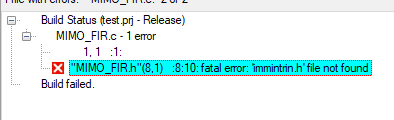

I have previously used GCC compiler to compile my dll and it worked flawlessly when it is run inside the host PC. However, when I move the same vi into the RT target (PharLap OS), it couldn't run and give me an error 1097. (Any advice on this as well?)
So, I suspect that this has something to do with the compiler, and hence decide to compile using LabWindows/CVI with built-in clang 3.3 compiler as it has the option to compile to real-time-only runtime. When I tried to create a custom compiler and additionally enabling -mavx flag for the build-in clang 3.3 compiler (see attachment below), the immintrin.h file couldn't be found.
Does LabWindows/CVI compiler support AVX instructions? If so, how do I add the immintrin.h file into it?

edit*:  For some resason, clang couldn't resolve -mavx and -march=arch flag? Is there really a limitation in using dll in real-time target?

Yes there certainly is. There are two main problems:
1) The Pharlap ETX OS only supports a subset of the Win32 API. It is basically the Windows NT 4 API except support for OLE,  user permission stuff and other such things that make not so much sense on an embedded system.
2) If you compile your DLL with anything but Visual Studio 6, (that includes just about every version of GCC derived compiler too), your DLL links with a compiler version specific C Runtime library. This runtime library needs to be installed on the Pharlap ETS, but all modern C Runtime libraries make use of some Win32 APIs for runtime initialization, exception handlers and such that are not supported by the Pharlap ETS Win32 API.
NI purchased the right from Microsoft to port their C Runtime library to Pharlap ETS and it has created certain versions of it that you can install on the Pharlap ETS. There are no other C Runtimes available to install on the Pharlap ETS system and porting another C Runtime version for any compiler, while not impossible is a very substantial work.

Hi rolfk,
Thanks for replying to my message. I now understand the severe limitation in using PharLap ETS, and LabWindows/CVI too as it is designed for outdated compilers. This means that LabWindows is a no-go for compiling AVX instructions.
As AVX instruction sets only started from 2010 onwards, is it true to say that the only way to compile this and get it work in PharLap OS is to compile through Visual Studio 2010? (the link you provided did mention support for 2010 version)
As I am planning to implement the controller to PXie8880 and 8135, one possible solution to do this is to migrate the OS to Linux RT for PXIe8880 so I may have the chance to use gcc compiler. What is the limitation for Linux RT for dll then? Will migrating it help fix the problem?
If it's still not possible, is there any other suggestions in implementing this algorithm in RT target? I am thinking in downgrading AVX to SSE2 if there is no other choice...

You really like to run cutting edge border line, don't you?
The first AVX capable chips were in the Intel Sandy Bridge/Ivy Bridge and AMD Bulldozer/Piledriver with Sandy Bridge being presented in January 2011 and Bulldozer/Piledriver in October 2011. So even if Microsoft was blazing fast to add support to their C compiler for this new architecture (which they usually aren't), it would be impossible to have that added in Visual Studio 2010.
And it is not enough that a compiled object code makes use of the according instructions, the OS on which it runs needs to be able to recognize and initialize the CPU correctly for this to work. Which Pharlap ETS definitely and positively won't do. Pharlap ETS was put in maintenance mode somewhere around 2008 and completely discontinued in around 2013. Only customers with an existing and valid license agreement at that time were still able to get the SDK downloads and technical support. And since 2013 you only can buy runtime licenses from them if you have an active agreement with them and you can't enter such an agreement anymore.
SSE2 should be ok on Core2 or newer CPUs as well as AMD K8. Your 8880 controller uses the Xeon E5-2618L CPU which is a Haswell core and would support up to AVX2. But you would need the variant with Windows 7 or Windows 10 or with NI Linux RT installed to have any chance. As far as NI Linux RT goes it should be ok, although I'm not sure if the NI variant is compiled with AVX support enabled. The first kernel which had support was apparently 2.6.30 and NI Linux RT uses normally at least 4.1 or higher. But during the compilation of the kernel that needs to be enabled and there might be reasons not to enable that for a RT system.
