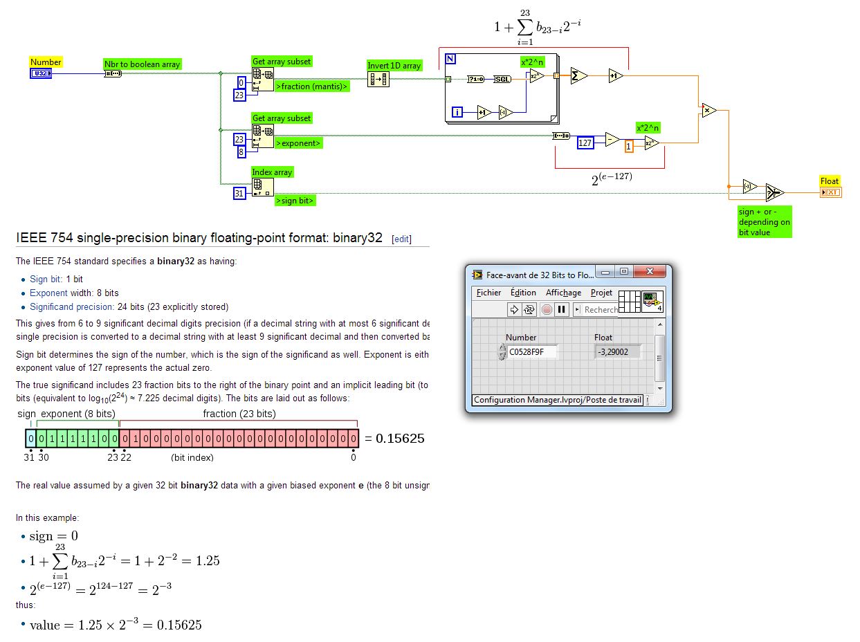

Roberto's solution is goog and probably more simple than bit considerations, as explained here :
http://en.wikipedia.org/wiki/Single-precision_floating-point_format
I know that it's not LV forum but the following LV implementation could be done with CVI as well...Anyway, Roberto's workaround is smarter ! ^^
Message 3 of 10
