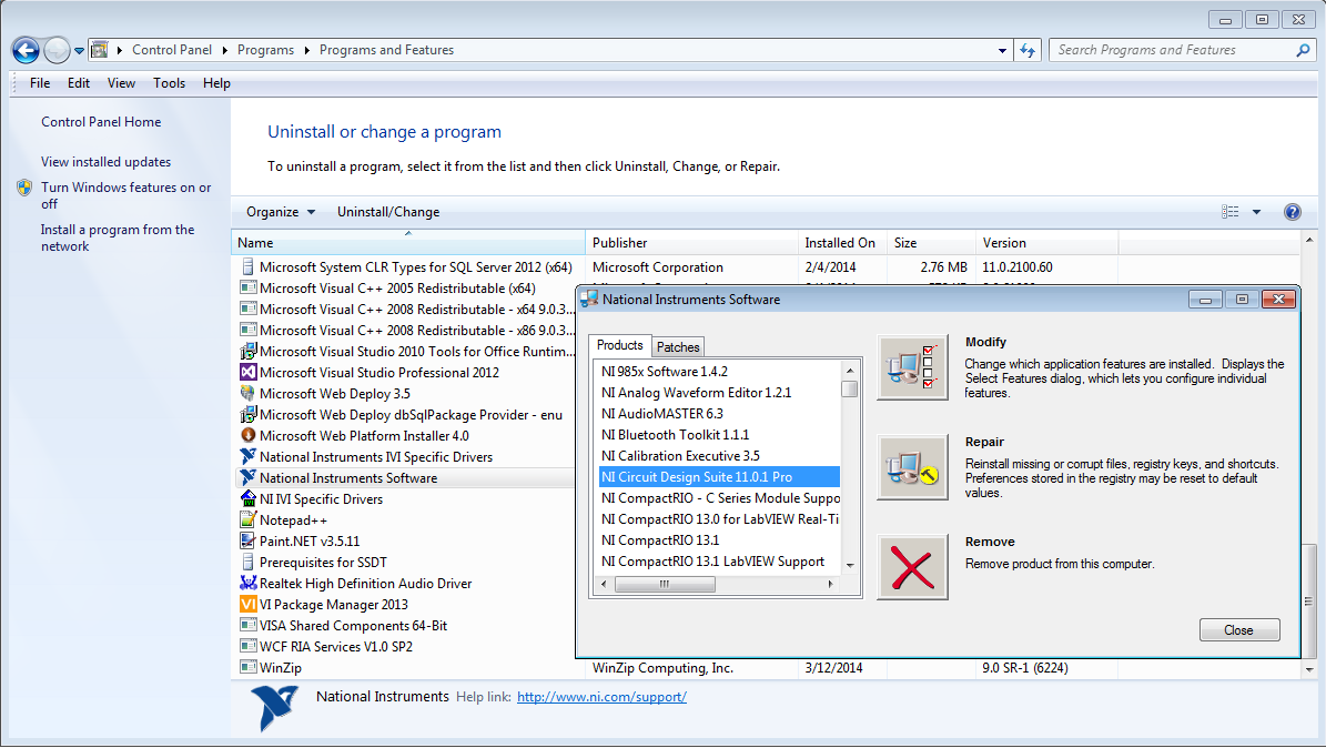

I uninstalled multisim through control panel and i deleted all the services using safe mode in my computer.I also rebooted my system after uninstalling.
Is there any separate uninstaller for multisim?

Please open up your Window's Control Panel and verify you have uninstalled the NI Circuit Design Suite 11.0.01. Please see the screenshot below. If it shows up in this list, then you did not actually uninstall Multisim, and perhaps you uninstalled the NI Multisim API Toolkit instead, which is separate. I believe you will have to uninstall the entire suite, which includes Ultiboard, otherwise the installer will think you still have both installed.
