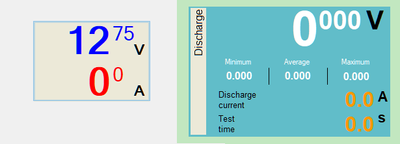

Hello Roberto,
Your suggestion has been on my mind for a long time.
But I haven't dared ask you.
It's a very cool and great display.
Perhaps you have a working example?
Thanks.
Patrick
Certified LabWindows/CVI DEVELOPER (2004)
LabVIEW since 5.01 | LabWindows/CVI since 4.01
Message 16 of 18
(1,838 Views)
Hello Patrick, there's no magic in that, just a little bit of creativity! And I can share it with you.
I have basically leveraged the transparent color to tailor the numerics and used two different indicators for integer and fractional digits with a custom function to write values to them.
Using transparent color can be tricky in case your panels have the Use Windows Visual Styles for Controls attribute enabled, since you cannot paint the frame in transparent on them. In this case I use a dummy panel without that attribute set and customize controls according to my needs. Customized controls can next be cut and pasted on the destination panel maintaining the transparency you set in the dummy panel. 😉
The two-dimensions indicator is basically built with two separate indicators put side-by-side:
  • Indicator for integer portion: use a double with 0 precision, right-aligned
  • Indicator for fractional part: use a double with 0 precision and padding equal to the number of decimal digits you need, left-aligned
Writing to this indicator is performed via this function:
/// HIFN ComplexInd ()
/// HIFN Show a value on a complex indicator (actually two
/// HIFN separate indicators for integer and fractional part)
/// HIPAR panel/Handle of the panel that hosts indicators
/// HIPAR ctlInt/Indicator used for integer part of the measure
/// HIPAR ctlDec/Indicator for fractional part
/// HIPAR val/Value to show
/// HIPAR nDec/Precision (number of decimals)
void CVIFUNC ComplexInd (int panel, int ctlInt, int ctlDec, double val, int nDec)
	double	intg, frac, scale = pow (10, nDec);
	// Split integer and fractional parts
	frac = modf (val, &intg); frac *= scale;
	if (frac < 1.0e-4) frac = 0.0;	// Avoid showing too small numbers
	// Avoid showing (1+100 hundreds)
	if (frac > scale - 1.0) { intg += 1.0; frac = 0.0; }
	// Show values
	SetCtrlAttribute (panel, ctlInt, ATTR_CTRL_VAL, intg);
	SetCtrlAttribute (panel, ctlDec, ATTR_CTRL_VAL, frac);
	return;

Hello Roberto,
Thank you very much.
You're always so helpful.
I suspected the solution, but I wanted to be sure.
The visual is so awesome 😎
Patrick.
