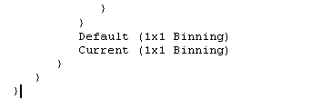

Looks like the camera file still reflects 1x1 bining, the file you uploaded is the file that is currently deployed correct?
I found this at the very end of the RTF. Perhaps the bining attributes are not explicitly set by above code?
