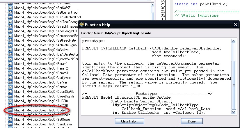

I used the Create ActiveX Controller feature to create a FP.  The ActiveX is part of Mach3, a CNC control program.  The ActiveX has methods like Code(LPCTSTR) that allows you to send G-Code strings to the CNC machine (G-Code is a text-based motor control language).
The weird thing is that most of the methods in the ActiveX control were imported as events with callbacks.  For example, the only reference to the Code function in the FP is under Event Callback Registration Functions->IMyScriptObject->IMySriptObjectRegOnCode.  The prototype for the callback includes a char * which I assume maps to the LPCTSTR parameter.
I don't understand why the methods are imported as callbacks.  I've been working with Mach3 tech support, but they don't know anything about CVI. Here's what they told me about their server:
There are two interfaces that you can get into... One is called Mach4 the other is MyScriptObject, The My script object is all the methods that are used in the VB scripting in Mach3... when I wrap the class in VS I can select what set of objects I would like to get... I am not sure how you do it without VS..
All the methods under Mach4 are imported as standard function calls.  Why would the "My script object" methods be imported as callbacks?  Is there some way to fix this in CVI, or is the problem in the ActiveX server itself?

Based on this document http://zone.ni.com/reference/en-XX/help/370051K-01/cvi/cviautomation_controller_advanced_o/ CVI should only generate a callback:
For each event object you select, the wizard generates a set of functions you can use to register callbacks for each event. LabWindows/CVI calls the callbacks when the server generates the events.

After installing the software i was able to generate a controller, and for the "Code" function i generated a callback called Mach4_IMyScriptObjectRetOnCode. Have you been able to call this ActiveX server in another language such as C#? If so can you provide a very simple example of how to do this?
CVI generates functions from the wizard automatically based on their types and something in the Mach4 library is either being treated as an event callback or is not being recognized properly.
