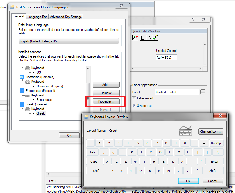

Actually, even absent Unicode support, in this particular case you don't have to be stuck with the NISYSTEM font.
You can use any common font, as long as you specify the Greek character set. This works because practically all non-Western character sets also support the unaccented western European characters (i.e. the ASCII codes 0 - 127). So, for example, while it's true that without Unicode you can't combine Greek characters with Turkish characters in the same text label, you can however combine Greek with English and you can combine Turkish with English.
Entering the text in the control is a different matter. If you're pasting the string, it's straightforward. But if you're typing, you need to toggle your keyboard language input, so that you can enter the codes that correspond to the character you want (for example, the omega character).
To change the keyboard input, you first need to make sure the language bar is visible in your taskbar:
Then you need to populate it with the languages you might ever want to enter:
Once you do this, you should have the languages you need in your taskbar:
You need to then pick the language corresponding to the characters you wish to enter and then type the keys that correspond to those characters. For the omega character, you'll need to switch to Greek and press the 'v' key (in a typical English keyboard):

Luis, that's definitely the best solution to this problem I've ever heard!
Till now I was used to type in the codes corresponding to the symbols I most frequently used (e.g. Alt+246 for ÷, or Alt+241 for ±), and I couldn't obtain the Ω!
I see that I can do the same programmatically, provided I ignore that in the source editor the string is displayed with a different symbol, trusting that the final result will be correct:
