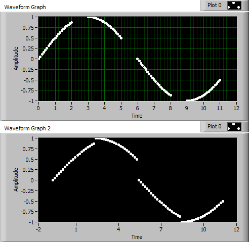

@altenbach wrote:
If all sections and gaps are the same length and you only want a single marker in the center of each segment, that should be easy to do with the current capabilities. (Defining markers). Of course the x-axis will no longer be linear in x (just in segments).
Here's a quick illustration of what I meant (these are waveform graphs, not xy graphs):
(One problem are the edge markers. Please vote for this old idea! )

the segments have the same length and can have the same color, but the gals have not the same length, it is important that the original x-axis values (time) are displayed.
