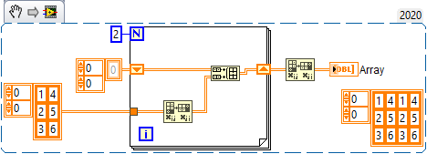

You need to build a larger 2D array in memory by concatenating each cycle’s 2D array horizontally (column-wise), then write the final array to the file once.
build array columnwisebuild array columnwise
The alternative is to change the file layout. Or rewrite the file each iteration.
I agree, change your code to append two rows with each iteration and document it. Even for a gigantic file, no existing data needs to ever be touched.
In particular, use low-level file i/o, open it before the loop, keep appending in the loop, and close when done.
You can always add a postprocessing step that generates the transposed file at the very end.
