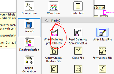

The red Cross means this VI is too old, it was created for LabVIEW 2012, you can replace the with the following VI
FrankenChino
