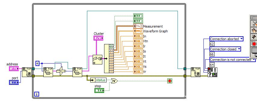

Hey Ray.R
I have a question, I was sending to another program the data from what I was measuring
It was 3 voltages and 3 currents, but now I want to send the others things
I have 2 graphs that I want to show in the other program via tcp/ip
and have 2 boolean variables... how can I send all these informations??
i will upload a screen shot of how I sent the 3 voltages and 3 currents
I don't know if i only have to put more input at the  build array
or if i have to send it from another way!
I don't know if you have the program yet, so I will upload it again for you
version 8.5 at LabVIEW
The red circles is what I want to send too!
Give me some feedback!
Message 48 of 59
(1,931 Views)
What is the program at the other end of the Ethernet connection?  Is it also LabVIEW?
Message Edited by Ray.R on 10-08-2009 05:59 PM
Message 49 of 59
(1,918 Views)
yeah is a program made with LABVIEW for me
I tryed use a bundle cluster...
But I'm receiving an error at my client.vi
Error 116 occurred at Unflatten From String in teste 4 - client.vi
Possible reason(s):
LabVIEW:  Unflatten or byte stream read operation failed due to corrupt, unexpected, or truncated data.
I will upload the client vi...
So maybe you can take a look
and tell me where i'm commiting a mistake
here are the 2 screen shots from my server and client too:
server:
Client:
Thanks for any help Ray.R!
