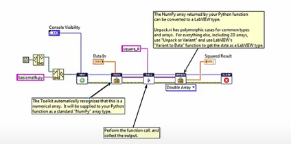

whats these elements called? Python integration
I was learning about python integration with Labview
so I was learning python toolkit by Enthought
Toolkit End of Life -- Porting to LabVIEW's native Python support – Enthought Knowledge Base

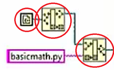

I was confused with one of the video lectures with the name of this element.
Webinar: Using Python and LabVIEW to Rapidly Solve Engineering Problems | Enthought - YouTube
timestamp 9:38

The first is the path of the current VI. The next is "Strip Path" which strips off the last element of the path. The last is "Build Path" which adds the filename/folder input to the path.

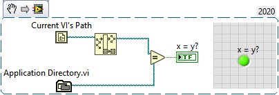

when you don't need the actual vi name, you can use the "application directory.vi"
