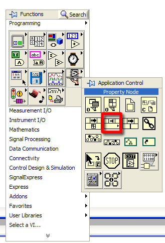

what is this?
Hi can someone please tell me what these are and where are they in the pallete? thanks!!
Message 1 of 29
(5,663 Views)
THey are property nodes and they are located here:
Tim
GHSP
Message 3 of 29
(5,650 Views)

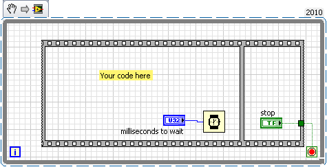

Thanks guys! I have one more question. I have a stop button in a while loop but every time i press it, it runs one more time before coming to a hault. How can I fix this glitch?
Message 9 of 29
(5,601 Views)
Make sure your loop code runs before the stop button is read.  About the only real use left for the sequence structure
"Should be" isn't "Is" -Jay
