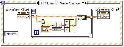

When adding the new plot first grab the history in the chart. Add another waveform (for the new data) that has empty Waveforms. Pass this to the History of teh WF Chart and THEN start presenting your new data.

This a variation on your working demo.
I'll leave deleting an arbitrary plot as an exercise for the reader. Smiley Wink
Ben
