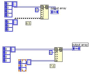

urgent: could anybody please explain that replace array subset error
I had to switch to a new PC today, which meant a switch from Win2k to XP and an update to labview 8.5.
When I opened my VI, that was compiling without errors on the old PC, labview displayed an error at a replace array subset function. I couldn't get it running so far.
I attached a simple VI that shows my problem: I have a 4D array and want to replace a 3D subset. I always end up with an a error as shown in the pic. Maybe I'm getting something wrong at the moment, but it doesn't make any sense to me & the VI has been working flawlessly on the old system. what's wrong here?

alright, I tried out some stuff using the replace array subset function. I've been able to replace a 2D subset in a 4D array, but for some reason I can't get it working to replace a 3D subset in a 4D array. what's wrong here?
Message 2 of 8
(3,860 Views)
BUG found!
It works in LV 7.0.
And in 8.5 AFTER you resize the replacement part to be 4D and then hit <CTRL-Z> ( or undo)
The shot below shows it before the workaround.
Ton

TonP,
do you suggest to add a dimension and then undo it? I am not sure if I get you right.
If so, try hitting the run button - you end up with a broken wire. I already noticed that, but it obviously was no use. 😞

TonP wrote:
And in 8.5 AFTER you resize the replacement part to be 4D and then hit ( or undo)
Just hold down <ctrl> and press the run button. It'll fix itself. 🙂
(Ctrl+Run recompiles the VI)
Message 5 of 8
(3,827 Views)
Yes I ment that, and yes I didn't hit the 'Run' button Smiley Sad
This is definitly a bug (I already posted it to the bug thread), you should contact your local NI rep, and submit the bug and get a CAR number.
Ton

@altenbach wrote:
Just hold down and press the run button. It'll fix itself. 🙂
Not on my system (Win XP, LV 8.5)
Ton
My LabVIEW Ideas
Message 7 of 8
(3,822 Views)
This bug is currently listed on the LabVIEW 8.5 Known Issues webpage.  The CAR number is 4CFADPDX.
