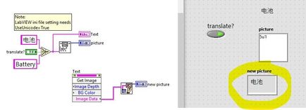

Does anyone have an idea how to display Unicode text in a picture control?
here's my code to show the problem:

Hi Al,
read an image of your string indicator (using an invoke node) and paint this into your picture indicator…
(2,749 Views)
Thanks!
worked perfectly...
