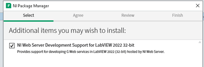

trouble installing web server development support for 32 bit
1. I tried doing fresh install of labview, but NI web server development was causing issue, so I unchecked it & installed rest of labview.
2. After install, i update labview and tried again installing web server via package manager.
Rest all of labview is updated
3. got below error

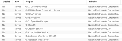

4. In Task manager I have disabled all of NI services except NI service locator, as they are not requried it seems & slows down cpu.
Please advise if any of services is critical and has to be run.,

Sadly, NIPM is not "robust", and will frequently cause installation errors, including with the last two LabVIEW releases.  A decade and a half ago, when LabVIEW was much simpler, installation issues, often involving starting necessary LabVIEW Services  could occasionally creep in, but since LabVIEW 2017 and NIPM, they have become far more frequent.
I notice you have a lot of Services installed, including some I've never encountered.  I wonder if you are "installing too much" and overwhelming NIPM.
Can you please provide some additional information:
  • How many (and what, both in Year and in Bits) LabVIEW Versions are installed?
  • What additional Modules and Toolkits (found on the first page of the NIPM Installation) are you using?
  • What Drivers (other than DAQmx, GPIB/IEEE 488, and VISA) are you using?
For what it is worth, I usually install LabVIEW in multiple passes.  Where it is difficult or problematic, I also try to install on a machine with no other NI software installed, for example, by spinning up a VM that doesn't (yet) have LabVIEW.  You want your test system to have only a single "edition" installed.

4. What services I should kept running in labview, as posted in #1?
(2,106 Views)
If you installed all available Modules and Toolkits in LabVIEW, you need to keep all of the LabVIEW Services running.  But why did you install everything?  You should install only what you need.
I recommend that you do a complete removal of all NI Software (all versions).  I assume (since you've said you've done it once) you know how to do it.  Be sure to run NIPM at least 3 times -- first to uninstall all NI software (including Multisim and Ultibord), second to remove NIPM, and third to remove "old junk that NIPM can't remove" (there can be hundreds of modules still present).

That is not a real solution for the actual problem.  NI needs to FIX this particular installer.  It seems to be related to their new System Link product aka "Skyline"
NI Web Server Development Support for LabVIEW 2020 32-Bit is the installer in question.
So unless this is needed for your development, simply leave it unchecked.
I tried installing NI System Link before this installer and it still FAILED with the RabbitMQ MSI message shown before on other related threads.
So that did not help.  The installer is broken dependent on some RabbitMQ service and SSL layer driver that may or may not have been loaded properly in previous installations.
@NI can you guys fix this?  I want to say I had no issues installing the LabVIEW 2023 version of this.  But most features needed for project development require LabVIEW editions prior to 2023 (Soft Motion, Control Design & Simulation, etc. all abandoned in LV 2023+ support).
