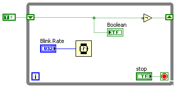

This is a rather old thread.  The original posters may no longer be monitoring it.
Here is a screenshot of the example along with a LV8.5 VI.
Note there were 2 different concepts mentioned.  One was toggling the value of the Boolean using Not and shift registers.  The other mentioned was the blink property that controls and indicators can have.  Actually 2 completely different concepts.
