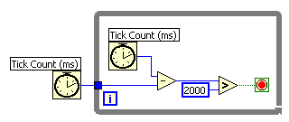

As I said, there's no built-in function to do a time out, so we're going to have build one.
In it's simplest from, all you need are two "Tick Count(ms)" functions, a "Subtract" and a "Greater Than".
The first Tick Count gets the current time in ms and sends this into the loop throught the tunnel. The Tick Count in the loop outputs the current time on every iteration of the loop so you can compare the current to the original from the loop tunnel. Just subtract these two values and see if it's larger than what your you want your time out to be. (specified in ms here, so this is a 2 second timeout)
One very important thing to keep in mind is that the loop MUST BE ITERATING for this to work. If something is stalling the loop and not letting it run, this will not work. The Tick Count functions (as with all functions and subVIs) are read or written to only once per loop iteration. You'll to figure out what is stalling the loop and fix that as well.
Let us know if you need more help on this.

There is timeout code similar to this in the Measure Pulse Width or Period functions that you are using. As I mentioned in one of your other posts on the same subject, you have the timeout set too high.

If you are referring to Ed's mention of the default being -1 this doesn't "cause" something to hang but it does cause the sub vi NOT to time out. Essentially you are setting the timeout value to infinity by setting the timeout to -1 or by not setting a value since the default is -1. Now I believe all timeouts are in milliseconds, so if you set the timeout to +1 the sub vi will timeout in one millisecond which is a bit quick.

Look again at the VI. The timeout is in seconds. With a -1 setting, you have it now set for about a 67 second timeout. I don't think you will like 5000 seconds any better. If the counter does timeout, the Boolean indicator called "timeout?" will be true. If you were to go to the help menu and enable the "Show Context Help", most of your questions about the VI that you are using will be answered.
