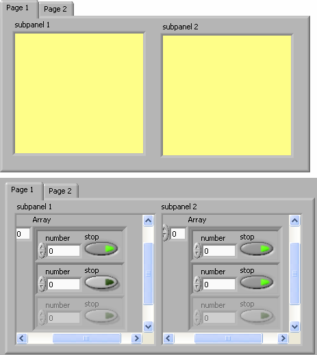

Also, similar to opening and manipulating a subvi panel in a subpanel of the main vi, it is possible to do so as well with vit, as depicted below:
in this example  the main vi includes several subpanels, which are empty when the vi is not running. in the diagram, we affect a reference to a single copy of the vit to every subpanel. data can be input to / retrieved from the vit via an invoke node. here is how thediagram could look like:
we create a vit, with the sole purpose to display and allow user manipulation of an array of clusters. of course such vit can support all the usual LV operations
When vi is not running, the subpanels are empty. as the main vi runs, the subpanels get filled with the vit front panel:
it is important to point that every panel now has its own dataset, either programmatically input in the main vi, or user-modified. it is subsequently possible to extract data separately from each subvi template.

I believe the use of scrollbars for VIs in subpanels changed from 7.1 to 8.0. It is now determined by the VI in the subpanel rather than the subpanel. If the VI in the subpanel shows scrollbars, then they are displayed in the subpanel frame.

Personally, sequence structures are messier than a nice error cluster in my book. Here's a quick redo with my suggestions (and a few more tips shown in green). You don't really even notice the error cluster! 🙂
Also, the "subVIT" in this case does not even need any loops. It is sufficient to contain the single control and nothing else. I also hide the scrollbars 🙂
I am still not quite sure where I would use all that, though... 😉
