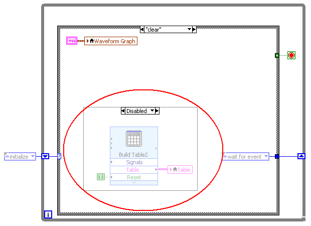

You forgot to include the state control (enum typedef).
Well made these three changes and you're good to go:
1.
Disable this code, as resetting (connecting TRUE constant) a new 'Build Table' express VI has nothing to do with the other 'Build Table' express VI placed in 'acquire' state.

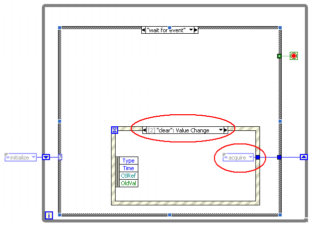

2.
Set next state as 'acquire', and make following change (point#3).
3.

So the point is...
'Build Table' express VI keeps the data in its buffer (uninitialized shift register implemented inside the express VI)... Now everytime when you add data, this express VI actually keeps on appending it to existing data...!!
Now in order to clear the data, one must input a TRUE boolean to this express VI's 'Reset' terminal and that's it.
