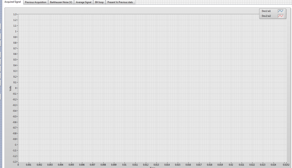

In my front panel I have a tab control containg 6 pages with waveform graph, I have a copy graph button on front panel which exports the image of waveform. My requirement is that I want to export the image of currently open tab with waveform graph. Exporting of image is done in a seperate vi, so my only option is to pass reference of tab control into that vi. I thought of using a case structure with each case handling each page of tab control. Does anybody have an idea of how to make case structure conform to handle each page of tab control ?

I have following front panel :

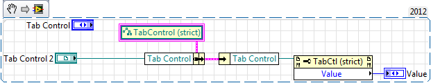

Not sure how you are doing this, but this is how I would bundle/unbundle the ref...
[edit] that's weird, the snippet turned my ref into control

Hi Raj,
You're seeing this conflict because the tab control refnum control is strictly type-defined (notice the red star in the bottom left corner) and something about the tab reference you're providing doesn't match up - it could be the number of tabs, names of tabs, tab order, etc. You should be able to resolve the conflict by right-clicking on the control within the cluster and deselecting the "Include Data Type" option.
@ billko - you get a control in the snippet because the snippet algorithm uses the "create SubVI" code path and exports the block diagram of the subVI that would be created.

This might explain it better:
Weakly-defined types allow for coercion, whereas the strictly type-defined reference will break if it doesn't receive an equivalent reference.
