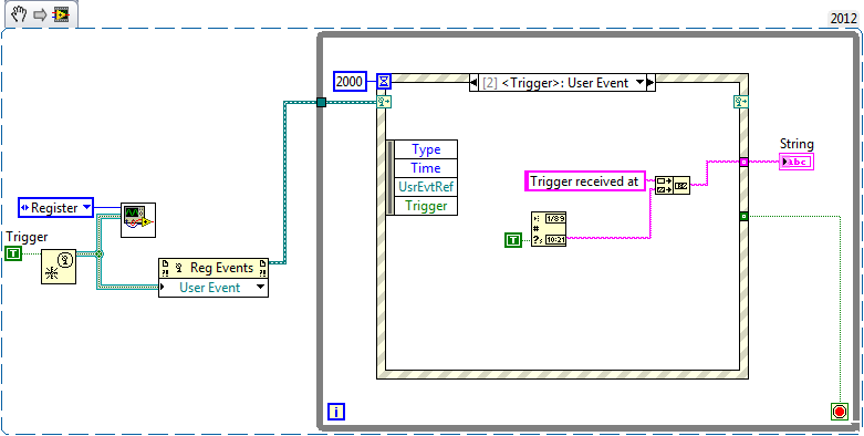

For a one-shot trigger like this, network streams and shared variables seem like overkill. If you're communicating between two applications on the same computer, or over a reliable network, a UDP read would be an easy approach. One application opens a UDP port and sits there with a forever timeout waiting for the trigger; the other sends the UDP trigger packet.
Another fairly simple approach uses VI Server. The application that's waiting for the trigger contains a functional global variable, which it initializes with a user event (or a queue or notifier). The sending application opens a VI Server connection to that functional global VI and runs it with the "set trigger" action, which generates the user event (or enqueues an item, or sets a notification). The application that's waiting for the trigger, and which contains the functional global, can then act on or respond to the trigger appropriately.

I finally had time to put together a quick example. This is just enough to demonstrate the idea. I didn't build the VIs into applications but you could do so; make sure VI Server is enabled in the application, and don't try to open the same TCP port for VI Server in both an application and LabVIEW at the same time. The information that the two applications (or VIs) need to share is the TCP port on which VI server is running, the name of the functional global, and the connector pane of the functional global (you could do this with an empty VI that has the controls on the front panel connected to the connector pane; you don't need to supply any code). Note that I selected port 4363 by right-clicking on My Computer in the Project Explorer, choosing Properties, and then making changes in the VI Server category. The access list also needs to allow access to the computer and the VI; for simplicity I set the access lists to allow "*" meaning all VIs and all computers, but you could restrict this.
The Functional Global Variable:
The VI that waits for the trigger (using a User Event, but a queue or notifier works too):
The VI that sends the trigger (opens a reference to the functional global and then runs it with the "Set Trigger" action, which generates a user event):
